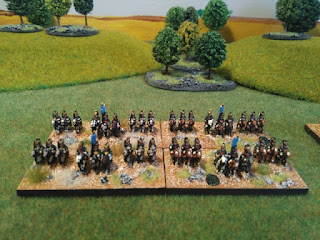

we are currently studying the basing of Our ACW project to play with Polemos or other rules... why not?
But for ACW as for FPW or napoleonic period, there are 2 options : 60x60 or 60x30mm bases...
We like very much the 60x60mm to make beautifull big base with terrain and place for skirmishers and don't really like the fact to place an second 60x30 base behing an other... not very beautifull looking for Us
What is the most populare? is one rules is better than the other? So if you have an opinion about the way to base... you are welcome!
Thanks for help!

Certainly the most difficult choice, both have good value. The 60x30 is by far the most popular choice.
You already know that if your objective is to have the best looking bases the 60x60 is the best one.
The 60x30 is the more popular because of a number of reasons. The first is tactically it's a better tool. You can change the shape of your brigades which is critical if your looking to represent deployment problems which were a real concern historically. Second is it will always allow you to mix up your formations for different orders of battle for different battles. Third is its generally easier to play other rule sets with minimal adjustments.
The 60x60 is generally intended to be used for "Brigade Games" which makes them a little awkward at times to be used for "Battalion" level games. Where as the 60x30 can be used for both. Most players that use 60x60 put two or more units on the base which means that these units are forever locked in together and can't be seperated for different battles. Unless you make them all non descrip or no name units.
So the 60x60 gives you the potential to maximize the look of a base and the 60x30 lets you maximize the tactical ability. I went with the 60x30 for all my units in all my horse and musket periods and have no regrets.  We also play the bigger battles just using a single 60x30 base, we don't put two of them together to make a 60x60.

That's very usefull and you are gave Us the points to choose... 30x60! Size We chosen for Our napoleonian bases for its playability,
while We chose 60x60 for Our Project Battle of Loigny!

12th Mar 2019 07:49:09
